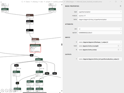

It seems to be a compiler bug coming form the node:
_dpgrnn_dpgrnn_0_intra_ln_LayerNormalization_output_0 
In the ST Edge AI Core 4.0, the error is a bit different:
ValueError: Shape and shape map lengths must be the same: [33, 16] vs. (CH,)
The model might be malformed as the infershape fails (onnx).
This is transmitted to the dev team but will be worked on depending on other priorities.
