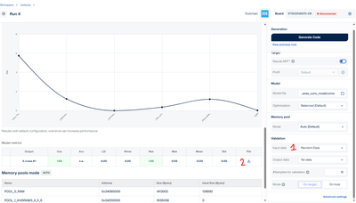

With this you can import input data as npz file or csv file (1) and get the output (2):
For your second question:
your model needs to receive the same kind of data you use to train it.
For your third question, if you do a validate, you get the confusion matrix in the CLI but I am pretty sure you have the real output in the generated files after the command in core. (in st_ai_output or st_ai_ws).
If you use the STM32Cube AI Studio, you directly have them as shown earlier.
