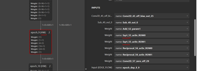

Hello ST Support Team,
I am using STM32N6 with Neural-ART NPU (ST Edge AI 3.0) and comparing inference outputs between:
1. TFLite on PC, and
2. the converted model running on STM32N6 NPU.
Could you please clarify how `rsqrt` is implemented on STM32N6 NPU?
I would like to know:
1. Is `rsqrt` a native HW operator, or is it decomposed (for example into `sqrt + reciprocal`)?
2. What approximation method is used internally (LUT / polynomial / Newton-Raphson / other)?
3. What numeric format is used in the HW path (fixed-point details, precision)?
4. What rounding and saturation rules are applied?
5. Are there documented error bounds or expected max/mean error vs float reference?
6. Is there any compiler/runtime option to select a more accurate vs faster mode for this operation?
My model uses INT8 I/O and the same input tensor on both platforms.
Thank you.

HI @retertert,
RSQRT is not supported on NPU:
https://stedgeai-dc.st.com/assets/embedded-docs/stneuralart_operator_support.html
It seems to be supported only for TFLITE models (not onnx):
https://stedgeai-dc.st.com/assets/embedded-docs/supported_ops_tflite.html#rsqrt
I asked for more details on its implementation
regarding your two last points, we don't provide such details for layers and there is no way to custom the behavior of a particular layer. For target without NPU, there is the possibility to "optimize" the model in such way, but the whole model, not just some layers.
