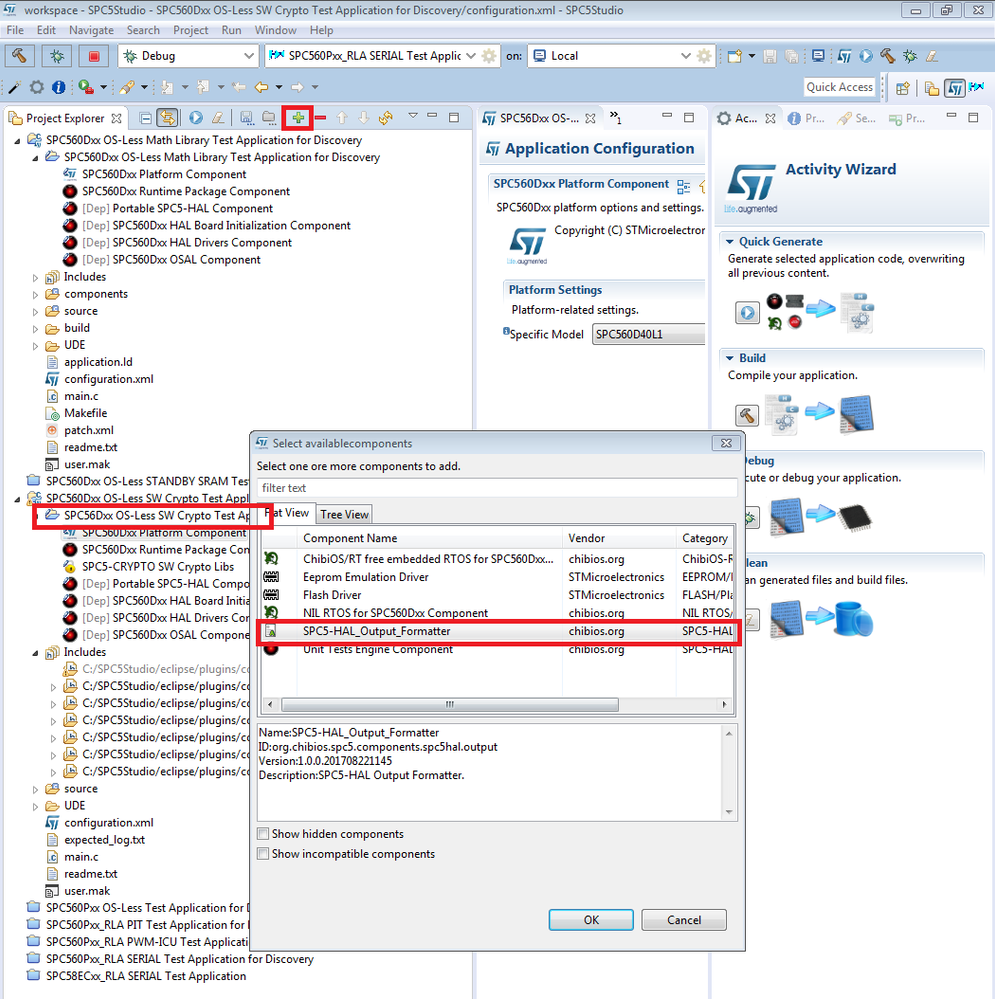

2017-09-28 12:10 AM
Hello Fabio ,
I think that you use SPC5Studio.
You can use the Ouput Formatter to perform this task. (RLA or HAL)
Best Regards
Erwan

2017-09-29 7:46 AM
Thank you Erwan
