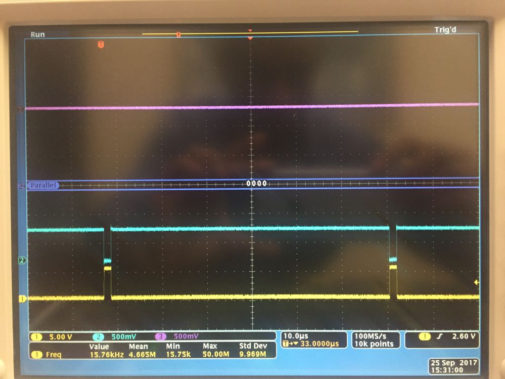

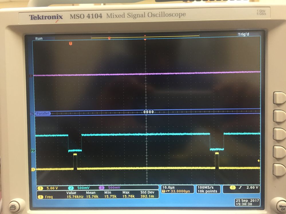

I was able to get it working partially.
I commented the INIT_SEL and RELOAD_SEL and had just the FORCE_SEL and it worked. The two submodules are now synchronously switching only if their duty cycles are same.
If their duty cycles are different, it does not work. Please see attached pictures. I have one of the submodules polarity inverted for the application.
Posted on September 26, 2017 at 00:11
Never mind. I figured this one out too.
The PWM was set to Align_Center and it should have been Align_Edge.
Sorry for the constant bombardment of replies in this thread.

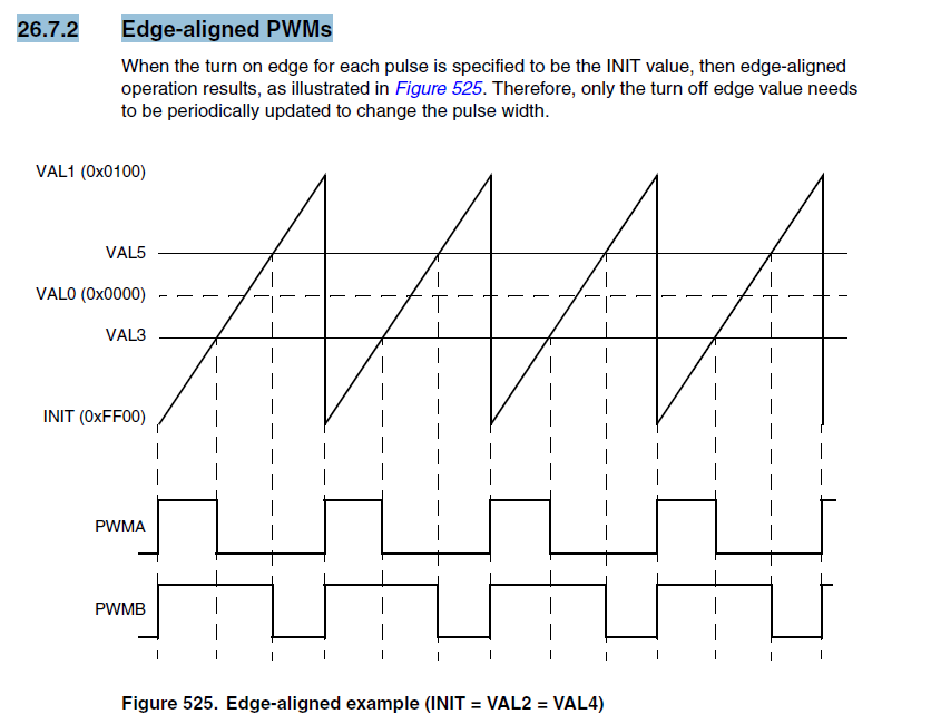

Erwan YVIN
Posted on September 26, 2017 at 10:31
Hello Raghu ,
you are not far from the solution
There is an example in the reference manual RM022
Coudl you try to update INIT = VAL2 = VAL4 ?
Chapter 26.7.2 Edge-aligned PWMs (INIT = VAL2 = VAL4)
   Best Regards
                        Erwan
