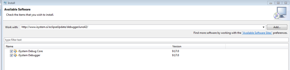

Anyway , SPC5Studio is a Luna Eclipse based IDE with CDT installed
you can install it on the update site and create an associated ISYSTEM Debug Configuration
