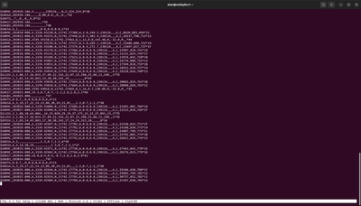

I've been trying to get the Virtual_COM_Port app running on the combination of X-NUCLEO-LIV4A1A and NUCLEO-U575ZI-Q board and the best I can get is where the app will successfully output the first second's group of NMEA messages to the PC running a terminal emulator program and then it stops.  After it stops, the actual LIV4 module on daughtercard cotinues to run as you can see the RED LED blink pattern change.

I did try to do some debugging and what I see is sometimes I get an exception and sometimes I don't.  I also see that if I put a breakpoint in the code where the serial data is copied from the LPUART1 to USART1 and hit run on each time the breakpoint is reached, the code continues to run OK and I get lots of messages.  If I then clear the breakpoint and let it run, then it again outputs a few messages and then stops.

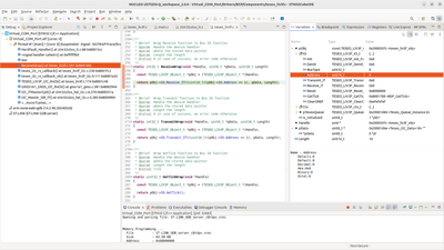

Screenshot example of when it does fail (see the same thing in downloaded example project, this screenshot is my manually created project).  When it does fail, it appears to be in the area of processing I2C receive message from the Teseo LIV4:

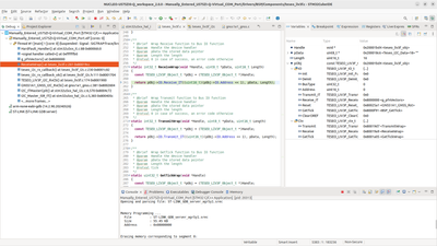

Fault shown on freshly built example code (6.0.0 GNSS1 version) and attached text file with exported variable values at time of call to Receive_IT (where exception occurred) in attached .txt file (some expansion of fields, not all as all expansion is huge):
BTW, on this fresh build, I didn't get any errors nor warnings and it built and compiled OK first time from building the example "as is" from STM32CubeMX code generation.

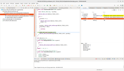

If I put a breakpoint on PRINT_OUT in TeseoConsumerTask, then hit run for each time the breakpoint occurs, then I keep getting messages one for each breakpoint occurrence and it is stable.  As soon as I let it free run, it runs for a few messages and then fails again.
