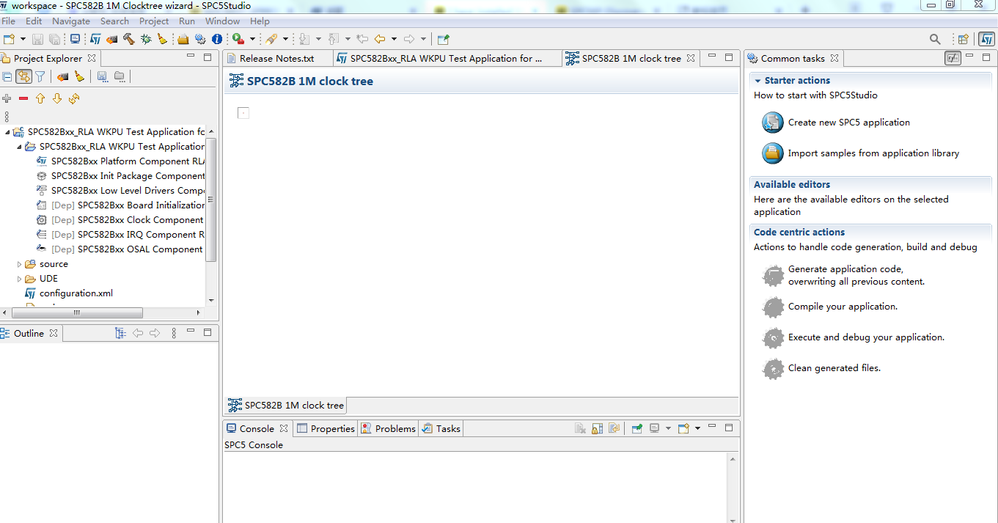

Even after restarting the computer, it won't work, and even if the software is reinstalled, it won't work!

Any update on how to display the clock tree ?

Hello ,
could you try on Windows 10 64 Bits ?
SPC5Studio is using :
java.version=11.0.7
java.vendor=GraalVM Community
BootLoader constants: OS=win32, ARCH=x86_64, WS=win32, NL=zh_CN

2024-08-23 4:35 AM - edited 2024-08-23 4:35 AM
I am using Windows 11 64 bits. I definitely cannot downgrade my OS.
The PinMap editor works good. But the SPC560Pxx RLA Clock tree doesn't work. Is there any other work around to access the PinMap ?
