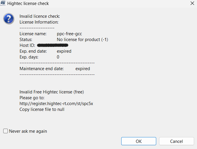

After installation of SPC5-Studio Green, I have copied my HighTec license file into C:\SPC5Studio-6.0\licenses, however SPC5 is showing the following screen.
The path it wants for the license file is 'null'. What can I do to get the license file to be recognized correctly?
If this license is not working correctly will the software be able to run properly? I have an ECU with code generated in Simulink using the SPC5-Studio compiler, does it need the license to be recognized for that compilation to work correctly?

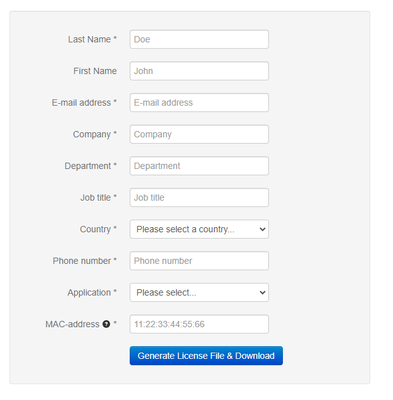

You need to to fill your correct MAC address :
https://register.hightec-rt.com/st/spc5x/
you need to copy in c:\SPC5Studio\licenses
check RLM_LICENSE
Otherwise , you can use ppc-freevle-gcc for your application (free gcc 4.9.4 (VLE mode)), you do not need the licence hightec for your application.
