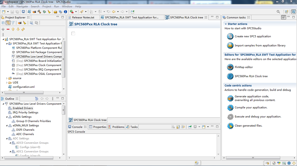

Even after restarting the computer, it won't work, and even if the software is reinstalled, it won't work!

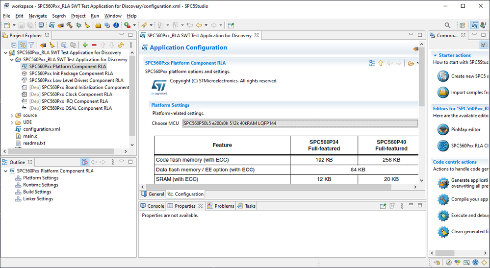

the graphical clock tree is not existing on all SPC5xx devices, which SPC5 MCU do you use ?
Best Regards.
2023-04-21 8:12 AM
I am using SPC560P MCU !

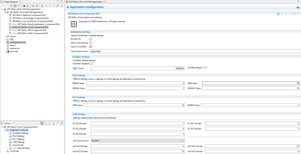

We do not have graphical clock tree for these 3 products:
SPC572Lxx
SPC574Sxx
SPC58xExx
But you can configure with the textual clock component:

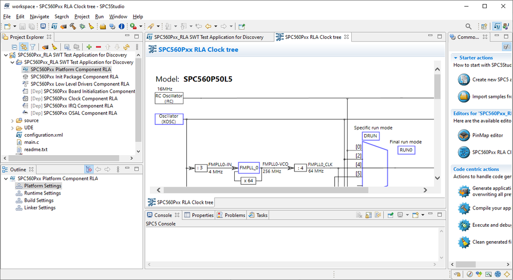

Can you help me see if I'm using SPC56P that doesn't show up !
2023-04-21 8:35 AM - edited 2023-11-20 7:30 AM
Do you have same MCU than me ?
2023-04-21 8:38 AM
would you please:
1) close SPC5Studio
2) erase .log file in C:\SPC5Studio-6.0\workspace\.metadata
3) open SPC5Studio
4) reproduce the issue
5) provide me the new .log file
