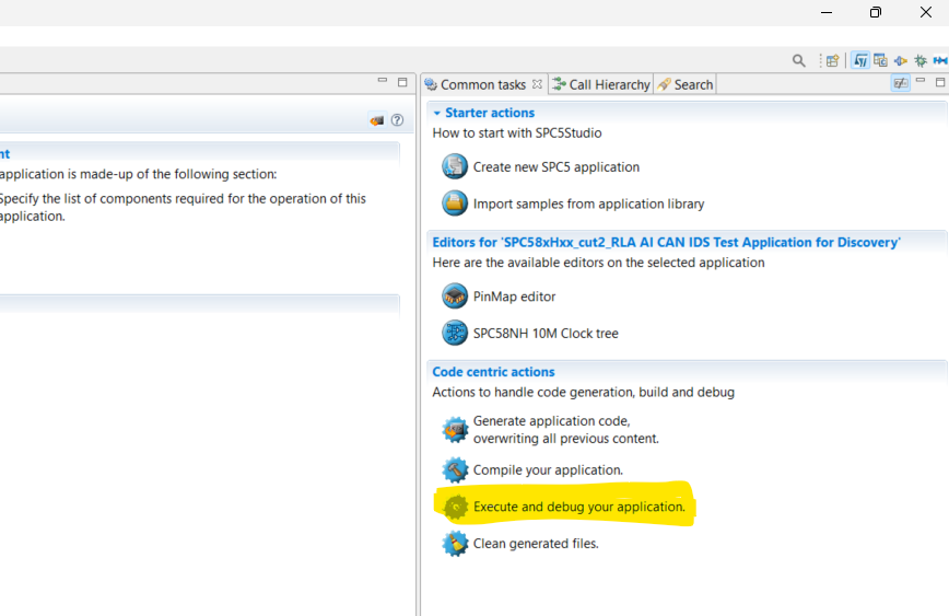

Unable to program binary image in SPC58NH-DISP board using SPC5Studio
I have SPC58NH-DISP board for my application development. I am trying to program the board using SPC5Studion but I am unable to do it. For me "Execute and Debug Your application" task is disable even if in SPC5Studio UDE plugin is installed. UDE plug in is installed by using this link  : "SPC5tools - http://spc5tools.spc5studio.com"".
NOTE: Board is connected and power supplied.

Hello ,
it is a PLS bug you should associate your file *.wsx on PLS UDE on your windows
https://community.st.com/t5/automotive-mcus/how-to-use-execute-and-debug-your-application-in-spc5-studio/m-p/320534#M2975

This SPC58NH-DISP board is connected with system through USB, But still I am not able to activate the debug session. Do we need to connect the UDE-STK dongle to activate the debug session ?
