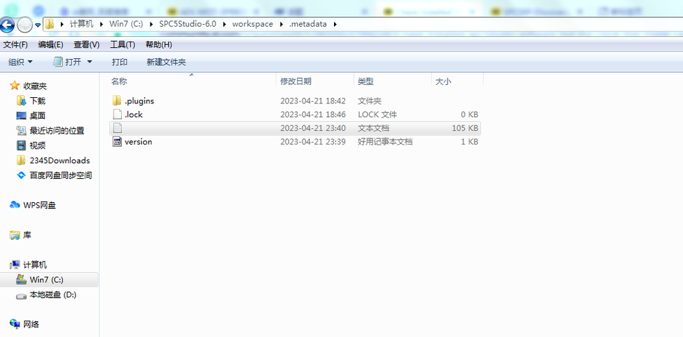

Sorry!
I didn't see any .log file inside !
It's sodifficult for me !
2023-04-21 8:52 AM
it is because you do not display file extension
you have "version.ini" displayed as "version" 1KB
and ".log" displayed as icon 105 KB
please send me the 105 KB file, it is your ".log"

2023-04-21 9:14 AM
I finally know where the log file is !
Thank you for teaching me so patiently! I'm so stupid!
