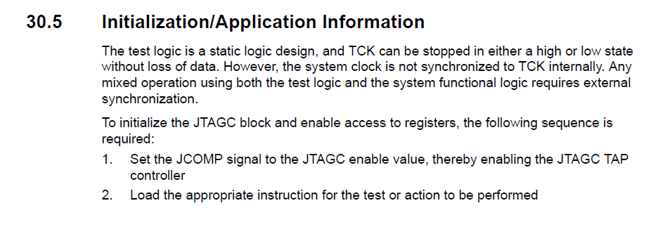

Hi Erwan,
As mentioned in previous reply, i am not using any board, but i am using SPC56EL60 in our own board.
Could you please clarify the point i mentioned above?
Also i found only 1 method to activate JTAG , and i think it is not based on Sw. please check attached Snapshot.0693W000001rzq3QAA.png
