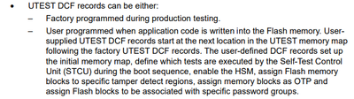

From the datasheet, the DCF can be programmed when the application code is written:

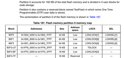

And the UTest partition can be access through the partition 0 of the flash array memory:
Which tell that the BOF-UT contain all the 16K of the UTEST memory map. In the Partition 0 ('0x18000000'). BOF-UT is located at 0x1FF80000. Does that means that I have to flash to the address 0x1FF80000 or do I have to flash to the address 0x18000000 + 160K (If the memory where continous)
But in any case:
This is from openocd running "flash banks"
I have to flash to the `0x18000000` section which correspond to the sr5e1.3.flash. but that section has a size of only 0x28000 aka the 32K + 64K + 64K of BOF0, BOF1, BOF2.
Can I really use openocd to flash that UTEST partition ? It seems that UTEST is not accessible to openocd ?

In attach you can find the script to program a DCF record with StellarLINK to enable boot from Flash at the USER VTOR ADDRESS.
Please follow these steps in order to configure the device by programming the DCFs in UTEST area:
The script searches the first free address in the UTEST area and here programs the value 0x0200000C08000000:
Refer to the Table 92. DCF client list in the section 7.4.1 DCF client list of RM0483 rev5.
Note: the search in UTEST area configured in the script is only an example and starts from address 0x1FF8_0388.
The first free address on a virgin production SR5E1 sample is at address 0x1FF8_0398, that is the "UTEST DCF Records".

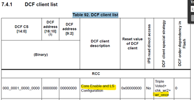

I wonder, the manual says UTEST is OTP. So Once LOCKSTEP is set, how can I go back?
Just write another DCF with value 0?
So BAF will use the latest one it finds?
2026-01-21 8:42 AM
The LockStep feature is permanent because the Global System Configuration DCF is write once.
Please refer to Table 92. DCF client list, the first item.
The user can write more times the Global System Configuration DCF but the next writes are dummy, only the first value is recognized and applied.
regards,
