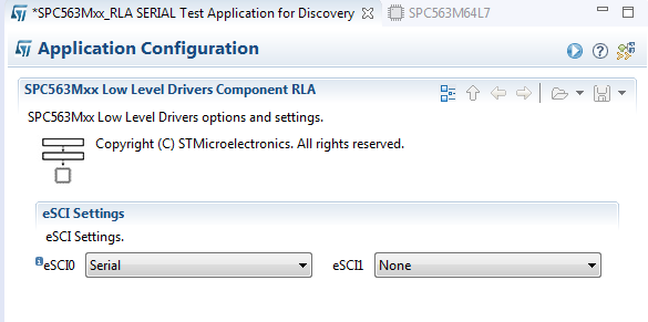

I've another question to do: I want to create a new program; I import the right libraries, I active Serial in 'SPC563Mxx Low Level Drivers Component RLA' and I select in eSCI0 the 'serial' option; so I generate the application. The program created doesn't work. Why?

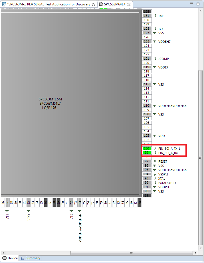

I've noticed that the folder named 'spc563mxx_board_initialization_component_rla' is different to the one of the example: inner files (board.h, in particular) don't declare several component such as PIN_SCI_A_RX and PIN_SCI_A_TX_1. Is this differences to cause this problem?

Hello Marco ,
I think that you forgot to enable the associated LINFLEX.
Low Level drivers RLA and Board Initialization Components (Pinmap Wizard)
when you use any IP in RLA or HAL you should enable it by the component
otherwise , the IP is not clocked and can generate an assert.
Compare the 2 configurations
Best regards
