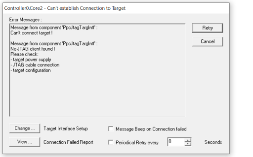

I have problems to flash a SPC5 MCU using UDE STK 4.8. I am using the PLS USB/JTAG Adapter for SPC5xxx. I have seen similar problems in this forum but I have tried different things during several hours and not solution has been reached.
I am using Microsoft Windows 10 Pro, version 1903.
I was able to use the program without problems the first day I installed it. However, problems appeared the day before. I tried also to install it in another laptop. It worked but once I shut it down and started again, it started to fail. Always with the same message.
I have tried different things:
Please, could you give me a new solution for this problem? This issue is delaying our team to deliver on time the software release to our customer. Thank you very much.

Hello Erwan,
We have designed a custom board using the following P/N: SPC58NN84C3RMHB and a 10-pin JTAG connector.
It is not a design problem, it seems to be a problem with the OS of the laptop.
Thank you for your support.

Hello MGuij ,
Did you have the same issue with discovery kit ?
Debugging issue can happen with not enough power supply.
Best regards
