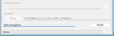

Then I tried generating the code for FW Updater example program, the Teseo Suit Can not do anything. It stops at Syncing, or if I try to force the update, at around 80% it freezes and recommends recovery mode. That doesn't work either.

Associate III
update:
teseo update was succesfull.

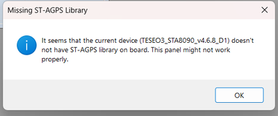

Thank you for the quick answer! I did reupload the correct firmware: STA8090_4_6_8_2_UPG26. However, now I get the error in Teseo Suite:

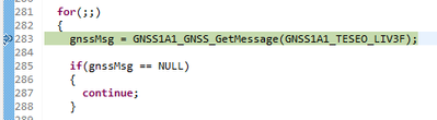

 GetGNSS message is still returning NULL however. After a power reset no such error showed up again.
I do not have the specific STM32 to try out. I have the NUCLEO-F401RE with me.  Also, I am surprised to see such an error coming out of Teseo Suite, therefore can we take this step-by-step?

When you programmed LIV3F with the firmware version shown above, did you use Teseo Suite or the firmware upgrader tool?
Could you please let me know what you are referring by your quote above?

I used the TESEO suite for updating the fw.

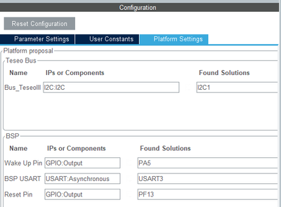

For me it is setup a bit differently. Im using the USART 6 as Asynchronous with 115200 baud rate of the NUCLEO-F446ZE. (Pins PG9, PG14 - > D0,D1). Jumpers on the GNSS1A1:

as for the message, this function returns a NULL value.

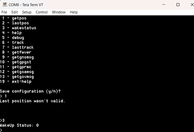

Running GetPos example code.

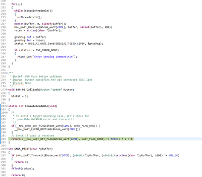

As for the VirtualComPort application is the loop where the app is stuck.
With the jumpers set up the way mentioned by you, Communication via I2C.
PPS blinking. PF13 set up as Reset Pin (GPIO status output HIGH)
Data is still yet to come.
Is USART6 between, STM32 and Teseo Module? If so, the module is configured by default at 9600, therefore setting the baud-rate to 115200 would be a problem.
