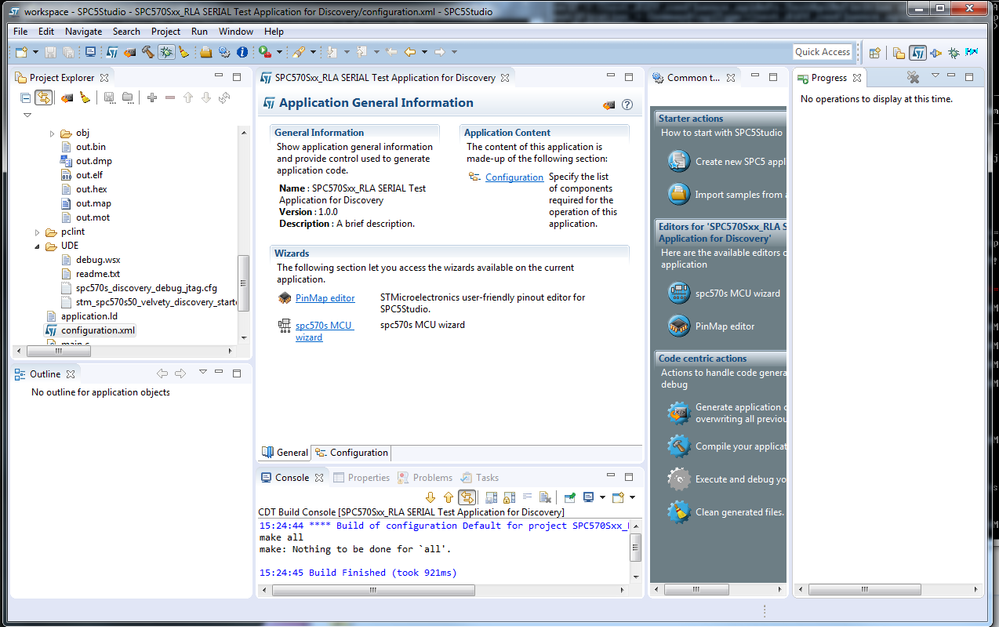

Using import wizard imported the SPC570SXX_RLA SERIAL Test Application for discovery, i generated application and built, following the instruction from
it failed on step 4 Flash and debug your application, My SPC5Studio has a ''Common task'' tab not the ''Activity Wizard'' shown in the instruction, noticed my ''Execute and debug your application'' is grey, click it or click the green bug icon nothing would happen.I don't know how to proceed from here, kind stuck.

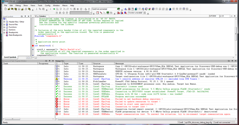

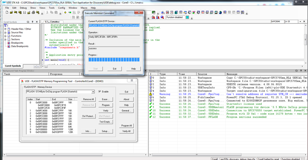

I re-installed PLS UDE debugger software 4.08.06, which is the latest version. Ran the PLS UDE debugger and opened C:\SPC5Studio\workspace\SPC570Sxx_RLA SERIAL Test Application for Discovery\UDE\debug.wsx file. I had the SPC570S-DISP board connected to Windows 7 and the PLS UDE debugger was able to connect to the board and program.
Then i set a breakpoint at line ''int main(voiu){'' and select ''Run program to Cursoe - F4'', it failed.

3) Is the SPC570SXX_RLA SERIAL Test Application for Discovery suitable for the SPC570S-DISP board? The error messages when i run the debugger, how to fix them?
2 screen shot, 1 showing programming ok, 2 showing Run to Cursor failed.
