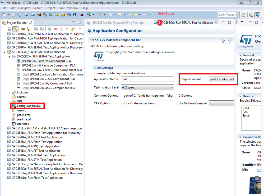

Hello Zhang ,
-mcpu=e200zx is for hightec compiler
-mcpu=e200z0 (or e200z4) shoudl be for the free compiler.
I think that you should use the free compiler.
Do you use SPC5Studio components ?
If yes , your configuration.xml is in ''dirty'' state, go back to your platform component choose , Save and regenerate
Best regards
Erwan
