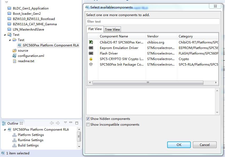

I need to update the SPC5 4.0 project to SPC5 5.6 project. But there is no SPC560Pxx IRQ component RLA in SPC5 5.6.

Hello Zhang ,
you have to choose the Init Package.
the Init Package is a meta component which Contains

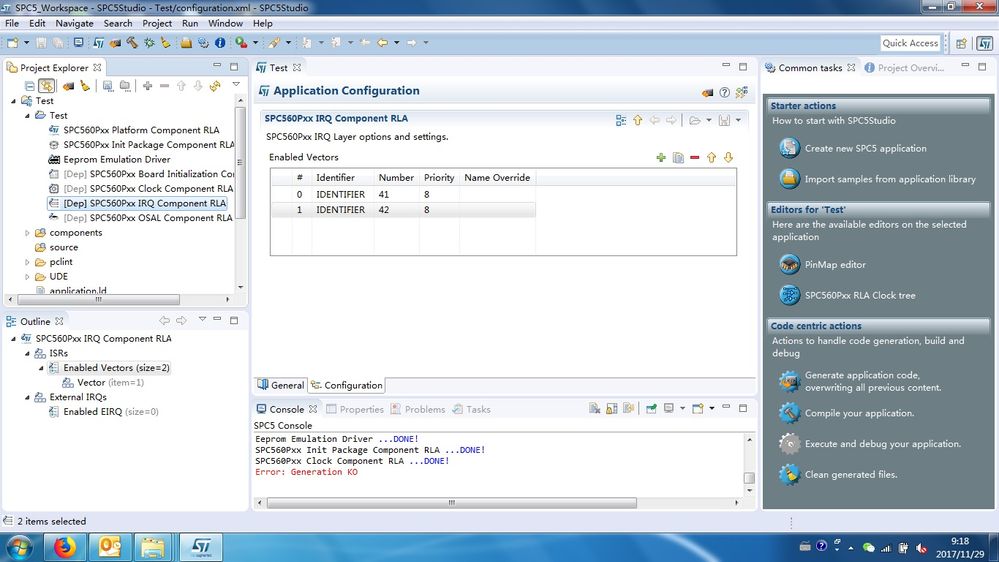

2017-11-28 6:20 PM
If I add the following two IRQ, there will be an error everytime. If I don't add the following two IRQ, there will be no error.

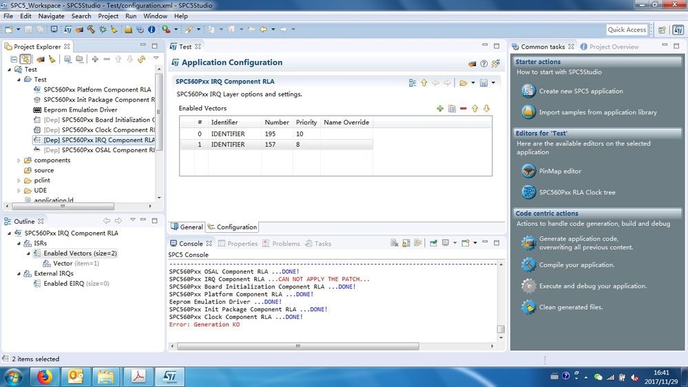

2017-11-29 12:54 AM
Hello Zhang ,
SPC5Studio has tried to apply the patch from your old application 4.0 'SPC560Pxx IRQ Component RLA' (not compliant anymore)
(cf Patch.xml)
You should remove your patch file or rename it before generating. (Example below)

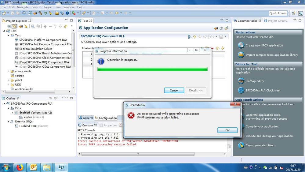

2017-11-29 1:30 AM
Hello Zhang ,
First , you have 2 exact identifier.Second , could you click on error Tab to check what is the error ?

2017-11-29 1:43 AM
I changed the IRQ number and the error is still there.
I put the log in the attachment.
________________ Attachments : .log.zip : https://st--c.eu10.content.force.com/sfc/dist/version/download/?oid=00Db0000000YtG6&ids=0680X000006HyHM&d=%2Fa%2F0X0000000b5P%2F.leknDbc99xVc02mdylVXegzH8RteVhTVQOB4JJfrno&asPdf=false2017-11-29 2:11 AM
For the last reply Nov 29, 2017 9:49 AM, I put the wrong log and then I update the log. I use SPC5 5.6 to create a new project not use the SPC5 5.6 open a SPC5 4.0 old project. Now I do it again and I put the newest log in the attachment.
