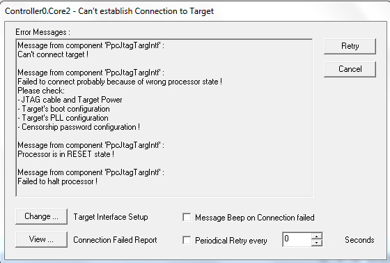

Hi, we are using Spc5 studio as IDE, UDE STK - 4.8 as Debugger.
Initially we flashed, debugged and observed output, After that we modified the code and flashed, Disconnected target connection. Then after we are trying to flash we are getting the following error messages and unable to flash.
we checked JTAG cable and Target power these are fine, Tried PC restart also still the same status.
Help us to where we can check Target's boot, PLL and Censorship password configuration, Processor RESET state.
Please look into this issue ASAP and let us know if we have to do anything else to flash the code.

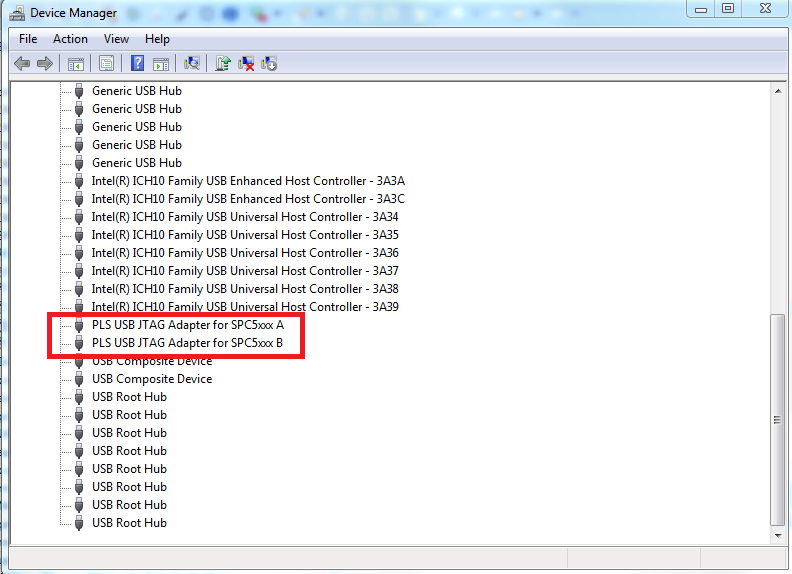

Hello Siva ,
You have to install the drivers located in c:\Program Files (x86)\pls\UDE Starterkit 4.8\Driver\JtagUsbDriver\
PLS Drivers should be installed
Could you check your device manager ?
Best regards
Erwan
2017-02-10 6:46 AM
Hi Erwan Y,
We already checked Device manager settings, C drive program files folder these are fine.
Please help us how to resolve this issue.
Thanks for your support.
Looking forward for your response.

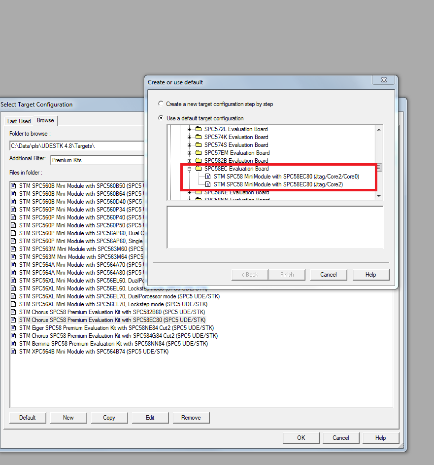

2017-02-13 2:03 AM
Hello Siva ,
You have to check your Target device (cfg file)
you can try in creating a new workspace debug
Which target do you use ?

2017-02-13 7:00 AM
Hello Siva ,
if you use
http://www.st.com/en/development-tools/spc5-udestk.html
you have to create you own workspace in PLS UDE 4.8
best regards
Erwan

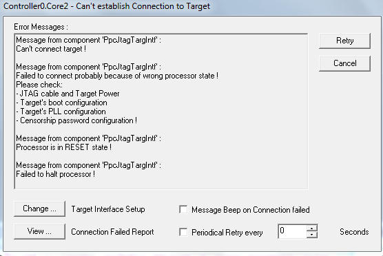

2017-02-13 10:41 PM
Hi Erwan Y,
I tried the above and getting the following error message as previous.
May I know the reason for getting the above error message.
2017-02-14 5:32 AM
Hello Siva ,
Did you update the censorship password ?
or maybe your board is in reset escalation.
try to connect in pushing the reset button.
Best regards
Erwan
2017-02-14 10:23 PM
Hi Erwan Y,
We are using default configuration (
censorship password and others are default only) to debug.
We already tried to connect in pushing the reset button, still the same behaviour.
May I know how to find board is in Reset escalation or not.
