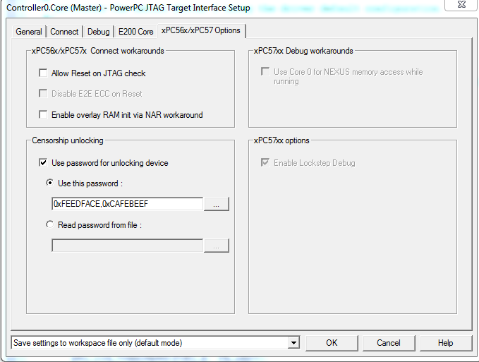

 I have already tried the censorship unlock feature under xPC56x/xPC57 Options in UDE STK 4.8. I have also tried reversing the password. Password I used is the default password (0xFEEDFACE,0xCAFEBEEF). Did I enable the censorship correctly, or did I miss something. Any suggestion would be helpful.

Have you enabled 0xFEEDFACE,0xCAFEBEEF in your debug configuration ?

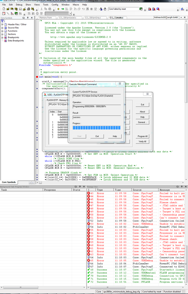

I tried to follow your instructions and if I power ON my module soon after pressing ''Retry'' option, I am able to connect to SPC560C50 target. But when I select my hex file or even try to program the module, it is giving the error as shown below.
I think the UDE STK software is trying to reset my module several times while trying to program. I was able to erase my flash one time. After that I am not able to erase or program it again.
Regards

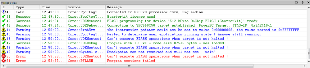

I tried every options in the PLS Debug options, still I am not able to load any firmware to the MCU. I can only erase my flash when I power on my MCU just after clicking the Retry option. I tried it on another controller also, the result is same.
When I try to select my hex file, I get the below warnings.
what does the warning at 44 mean ? when I try to program, errors at 50 and 51 are occurring.
