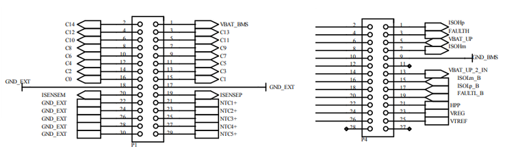

2) The connectors may be found on the documentation. You can find from this link.
I'll attach here for completion:

I have done the hardware part for the above:
1× AEK-POW-BMSCCTX (one node powered with 8 cells for bring-up).
Raspberry Pi with /dev/spidev0.0 enabled.
Cell stack: C0..C8 populated (8 cells ≈ 26 V).
Two GND_EXT pins tied to pack negative as per BMS hold manual.
P1 (cells)
C0–C8 → 8 cell taps (≈ 26 V total)
GND_EXT(×2) → pack negative
P4 (logic, to Raspberry Pi)
SDO (P4-2) → MISO (Pi GPIO9, pin 21)
GND_BMS → GND (Pi)
SCK (P4-4) → SCLK (Pi GPIO11, pin 23)
SDI (P4-6) → MOSI (Pi GPIO10, pin 19)
NCS (P4-8) → BCM5 (Pi pin 29) — we drive chip-select manually via GPIO (not CE0/CE1)
VDD → tried 5 V initially; for bring-up we now use/recommend 3.3 V
VIO (again) → 3.3 V
GND (shield ground) → GND (Pi)
Discrete enable pins (loose wires from P4 area)
DIS → GND (LOW)
TXEN → 3.3 V (HIGH)
NSLAVE → (important) should be GND (LOW) so L9963T behaves as an SPI slave ( It is already grounded in the datasheet)
