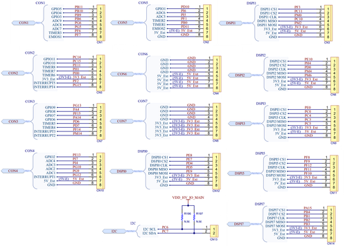

To do that you should take a look to the AEK_MCU_C4MINI extended connector, which can be also found on the C4MINI User Manual.

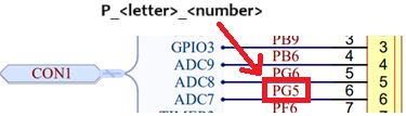

The pins you want to allocate are ADCSAR, so you should search in the scheme above which MCU pin are allocable as ADC.
When you find it:
In red you can see which P"x"y" combination configurable as ADC (i.e. PG5)

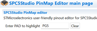

Then open
In the top left of the screen search for the pins you are looking for:
our C4MINI should have every pin allocated already, so you should see it highlighted in green.
If you click the pin, you will find it highlighted on the ADCSAR Outline window:

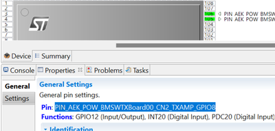

NOW, left click on the pin previously displayed with the "X" and copy the name from the General setting window:
(GPIO example)
Then right click on the PIN and deallocate it, selecting NOT USED:
Now deallocate the PG5 (if already allocated) and allocate it once again, as:
Make sure to paste the name you copied before!
