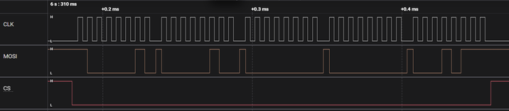

I'm working on a battery management system using an STM32F302 going to an AEK-COM-ISOSPI1 dev board using the L9963T transcevier which is daisy-chained to 10 AEK-POW-BMS63EN boards using the L9963E chip.
The problem that I'm having is that when I send a message over the ISO SPI lines, it adds an additional 0 before it sends the message.
I have attached two messages that show the leading 0 bit that is added. msg 0x55 55 55 55 55 and msg 0xFF 00 FF 00 FF.

It seems you are acquiring ISOSPI data with a sampler;
In order to help you with the analysis I need complete SPI signal waves.
Please probe the whole SPI signal (not ISOSPI) using a scope or a logic analyzer.
Make sure to acquire:
