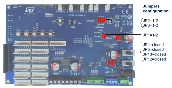

2025-12-15 1:20 AM - edited 2025-12-15 2:45 AM
Hi there,
Yes, it seems your SPI communication was not established.
This usually means C4MINI SPI line is not connected correctly, or the SPI signals are not generated.
First of all, check C4MINI Jumpers and retry:
If this doesn't solve your issue, I suggest you check once again C4MINI pin connection.

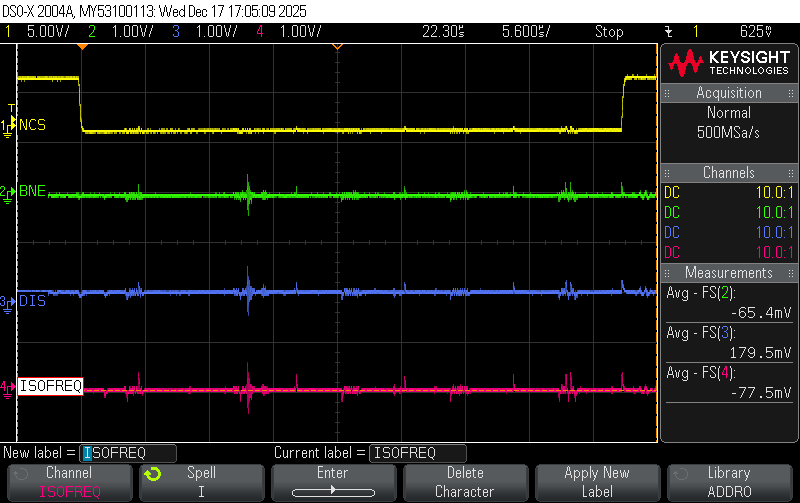

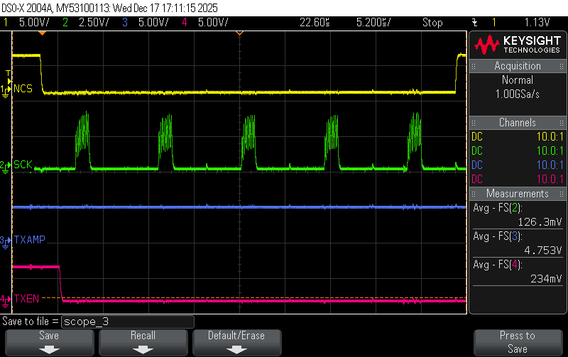

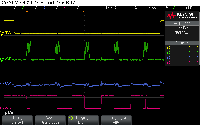

I am attaching the Oscilloscope reading please see them. The SCK reading is similar to @ritehracingteam issue, but the hotplug connection is there. I measured the voltages and found:
VREG = 6.6V, VCOM = 5V, VANA = 3.3V but VTREF = 0. I believe this is the default setting for the L9963E from datasheet. Although in the BMSCHAIN component VTREF is set to always on (5V). ISOLp and ISOLm are both +1.2V w.r.t to GND_BMS. I don't see any activity.
I also tried connecting the hotplug connection to VREG instead of VTREF, same results no changes.

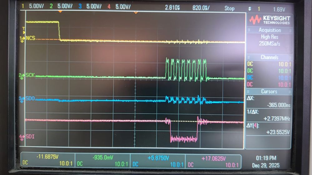

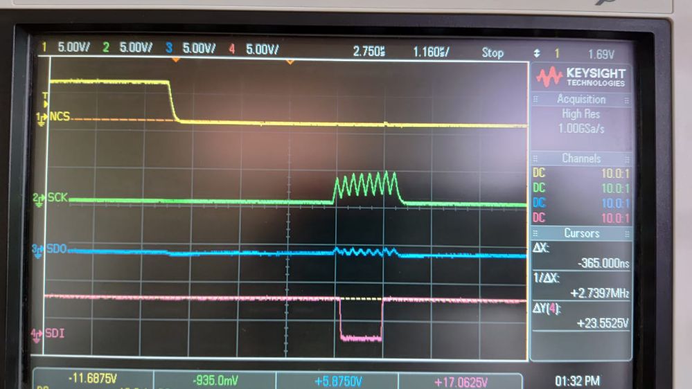

2025-12-28 10:46 PM
Hey Simone,
I tried changed the SCK pin setting from weak drive to strong drive since the clock was not square(See pic), still no D7 LED. Moreover after changing any setting in the demo the D2 LED doesn't light up. It only works with the demo as is. Is the L9963T faulty? Should I get a new board?
Regards,
Zen
Weak Drive
Strong Drive
2026-01-06 11:48 PM
Hi Zen,
From the signals it seems you are missing GND reference.
Make sure to connect the GND of your BMSCCTX to C4MINI GND
Best regards,
Simone
