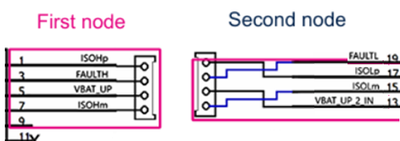

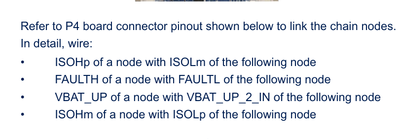

the problem i find is in the user manual3185, the figure for daisy chain is given as:
and it says to connect ISO Hp to ISO Lm of the next node (that is opposite polarity).
but when i looked in the L9963E datasheet, it is given as :
Here ISO HP is connected to ISO LP (that is same polarity)

Hi Amal,
The connections depicted in the diagrams you shared are the same.
Connect ISOH with ISOL of the corresponding polarity, so
ISOHp with ISOLp
ISOHm with ISOLm
BMSCC connectors kit is, in fact, guided. In the package you should find something similar:
If you prepare connectors by mean of it, connection mistakes are avoided.
For clarity, let me share a clearer connection scheme, with the second connector rotated by 180degrees:
Best Regards
Simone

2026-01-20 9:17 PM
Thank you for clarifying the doutb.
But still in the UM3185, the connection given in writing is reversed so i think it should be a mistake right
2026-01-20 11:44 PM - edited 2026-01-20 11:45 PM
You are right Amal, there is an errata in the description.
We'll fix on the next UM revision
Best regards,
