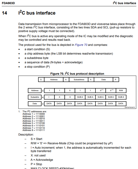

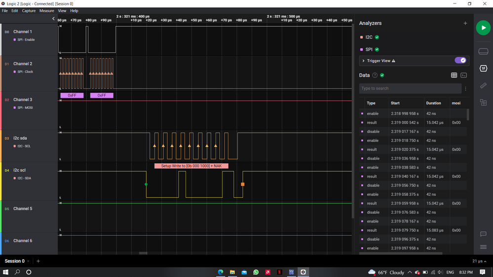

Mr max, im trying to follow the I2C register reset, but when i want to send some data to an address (for example address register 8) it gives me on my logic analyzer 0B0001000 + NACK, so i cant send data without the ack bit. do you know what could be possibly the mistake?

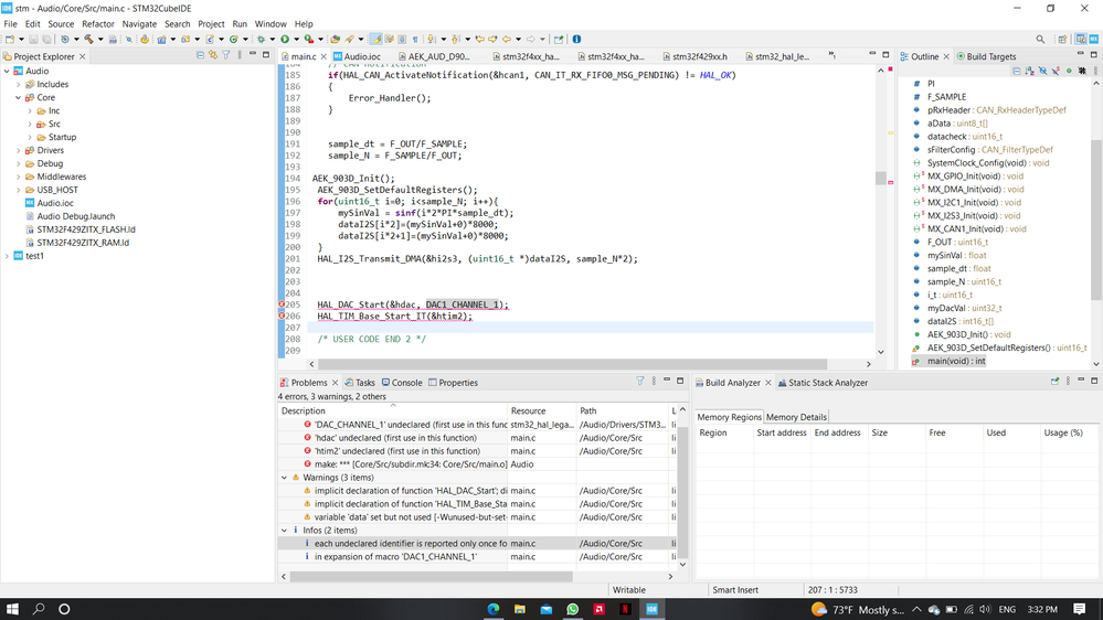

QUESTION 1: is the function that sends play correct?
QUESTION 2: i have error in the last two lines.
