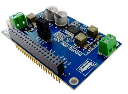

Hi, i have a AEK-AUD-D903V1 evaluation board and i want to make a simple AVAS project. I don't have any board with SPC582Bx microcontroller board. Can I implement this application to stm32 board ? if i can, how should i progress ?

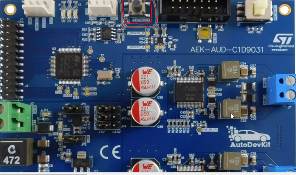

What do you mean by play/mute buttons? There is no button on the AEK-AUD-D903V1 board.
then, as I understand it's almost impossible to use FDA903V1 amplifier with stm32f407 board.
2022-08-01 8:09 AM
This button:
