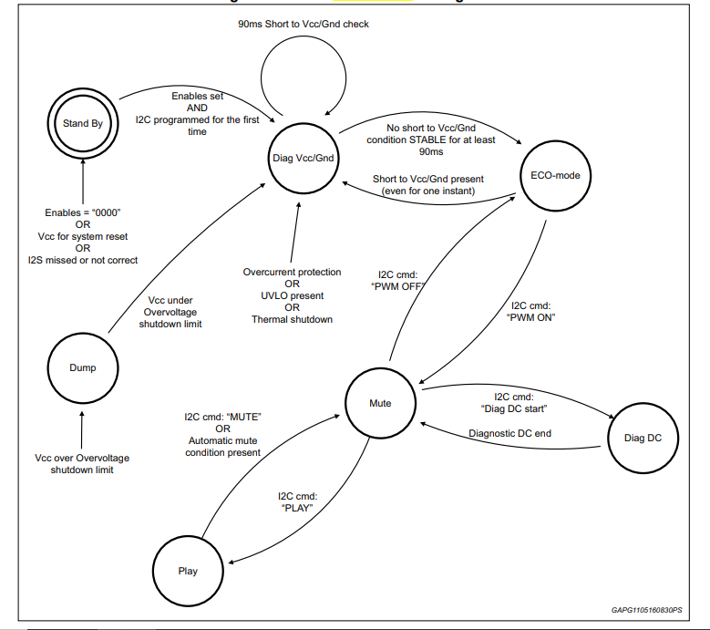

i have set enables 1,2,3 and 4 as 1100 which is address 2 , but for some reason the speaker is not open and voltage is not passing through it which means i cant move on and give orders through i2c registers, can you please explain what the reason might be?

The Enables set the I2C address nothing to do with the speaker.
Please follow the entire procedure include register reset to activate the I2C.

you need to follow the state machine to reach mute and play states and send I2S data
Please refer page 28 of FDA903D datasheet
