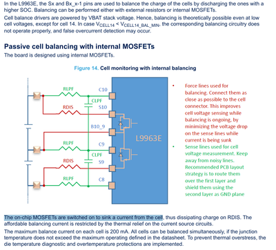

2024-12-25 1:04 AM
Dear Experts,
As in the document and figure, the on-chip MOSFETs are switched on to sink a current from the cell, thus dissipating charge on RDIS. So I want to ask that if balancing status of cell 1, 2, 3 ,4, 5 is on (value is 1) => the on-chip MOSFET of pin S1 S2 S3 S4 S5 are switched on right? I dont know how to know that the on-chip MOSFETs are switched on or off and how to control them?
Thank you for your attention to this matter. I appreciate your assistance in clarifying this detail.
Best regards,
Trishuynh.
