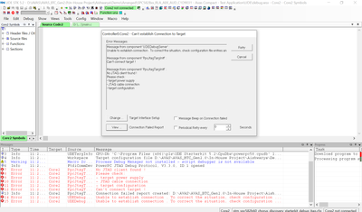

I am reaching out to seek your guidance regarding an issue I am encountering while flashing software. Despite following the standard procedures, I am facing the following errors (as shown in the attached snippet):
1. Getting the following errors shown in the snippet.
2. Even pressing on the hardware MUTE, reset and STOP/START key, noticed that the LED are not blinking as previous.
This happened sudden in between the flashing process

Hello Aishwaryaum,
looking the image, you sent, it seems to me that the code you are trying to flash on the board SPC56EL70L5DISP is not compatible with the micro on board (SPC56EL70L5).
Please could you check that the code you are flashing is compatible with the micro?

2025-01-13 12:52 AM
Hello Atroi,
Thank you for your valuable feedback.
Actually, I have been flashing the same code with some modification since so many months, I had never faced this issue.
Even during time when I got this error, I was flashing the code before and then modified and tried to flash latest version during that time I got this error.
So, I guess code is compatible with the micro on the board and this issue is due to some other reasons.
I appreciate your assistance and valuable input and looking forward to the community's responses.

2025-01-14 7:12 AM
Hello Aishwaryaum,
below are some steps to try to solve your problem:
1) Try to uninstall and reinstall the USB driver. Under the following path: C:\Program Files\pls\UDE
Starterkit 2021\Driver\JtagUsbDriver there are the files UninstallPlsUsbJtagDriver.bat and
InstallPlsUsbJtagDriver.bat that have to be executed as administrator.
2) If the issue persists, while press reset button on the board, try to connect with udestk,
if you can connect, erase the flash. After that, try again to flash your code.
3) To verify that the PC are able, to connect to UDESTK, in the log window verify that the line 5 appears as shown below:

2025-01-14 10:48 PM
Hello Atroi,
I have tried all the steps which you have mentioned but getting the same error (shown in the snippet).
I have attached the "Connection_Failed_Report", and I am requesting you to cross check once and let me know in what further ways I can resolve this issue.
