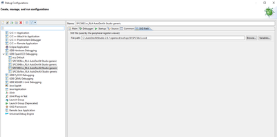

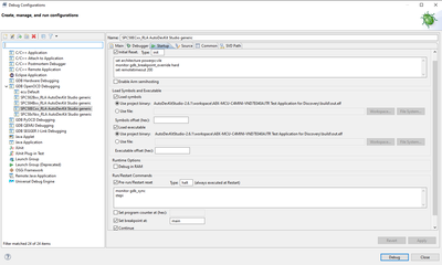

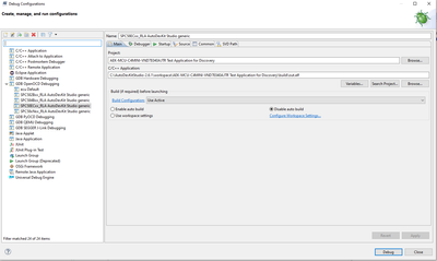

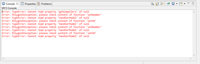

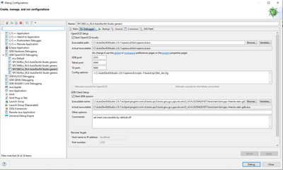

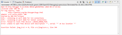

all done as per the images! still problem persist.
i am sharing the images also if i do any mistake or need any corrections
i think there is some problem which can be seen in last image!

By the console messages it seems that your FTDI drivers are corrupted.
You should:
1) Re-install the FTDI drivers
2) Check SPC5LNK/OpenOCD drivers using the manual procedure previously shared.
3) restart your pc
4) check that your USB cable is not broken
If after these four steps you cannot still flash your C4MINI, the only thing I can think of (assuming your MCU board is not broken) is that you may have activated another Windows application which is using the same serial port you are trying to use for flashing (causing congestion and data corruption).
