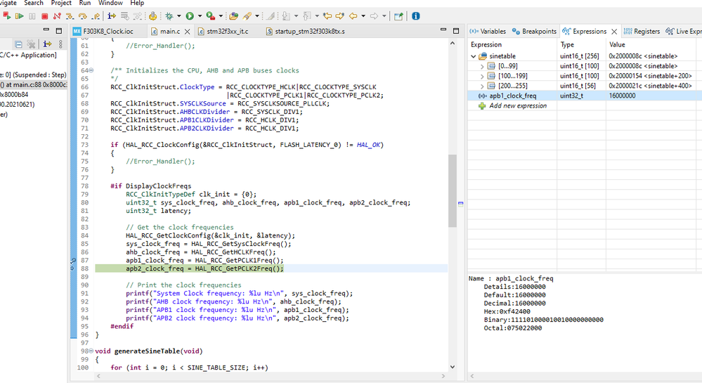

I am including a snapshot of the debug status of my APB1 clock, verifying that am running it at 16MHz
