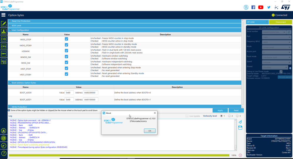

2022-04-22 5:40 AM
Yes, dual boot works just fine.
The problem is that I cannot disable nDBOOT with the latest Stm32CubeProgrammer because the option does not show up under option bytes. It works just fine with the old version of STM32CubeProgrammer that I used before.

Can you please share your screenshot to compare with mine ?
2022-04-22 6:43 AM
The nDBANK and nDBOOT are two separate flags and your image is missing the nDBOOT.
2022-04-22 6:47 AM
Your screenshot does not show nDBOOT either.
2022-04-26 2:33 AM
Hello @ASiem.3 ,
You are right ! ndBoot OB is missing in user configuration TAB,
I raise this issue internally to be fixed in CubeProgrammer future release.
Internal ticket number: 126991(PS: This is an internal tracking number and is not accessible or usable by customers).
Thanks to highlight this issue.

2023-07-31 12:47 PM
Hello ,
I'm using STM32_Programmer_CLI to program the STM32F76x and have issue to program the nDBoot option byte.
It shows up in STM32CubeProgrammer , but STM32_Programmer_CLI does not .
I think it is probably related to this problem . Do you know solution for this ?
I'm using STMCubeProgrammer v2.14.0
2023-08-01 5:46 AM
Hello @marcde,
Welcome to ST Community !
Correction hasn't been done yet for 1 MB flash size targets, the issue will be fixed in the next release of STM32CubeProgrammer.
Internal ticket number: 158507 (PS: This is an internal tracking number and is not accessible or usable by customers).
