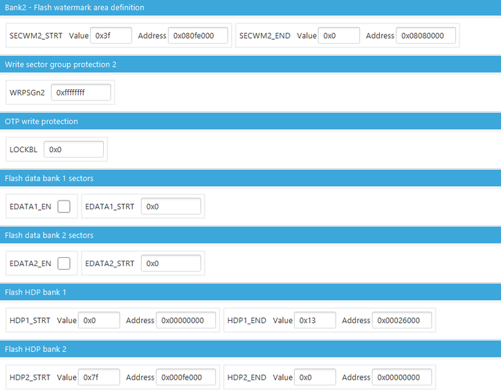

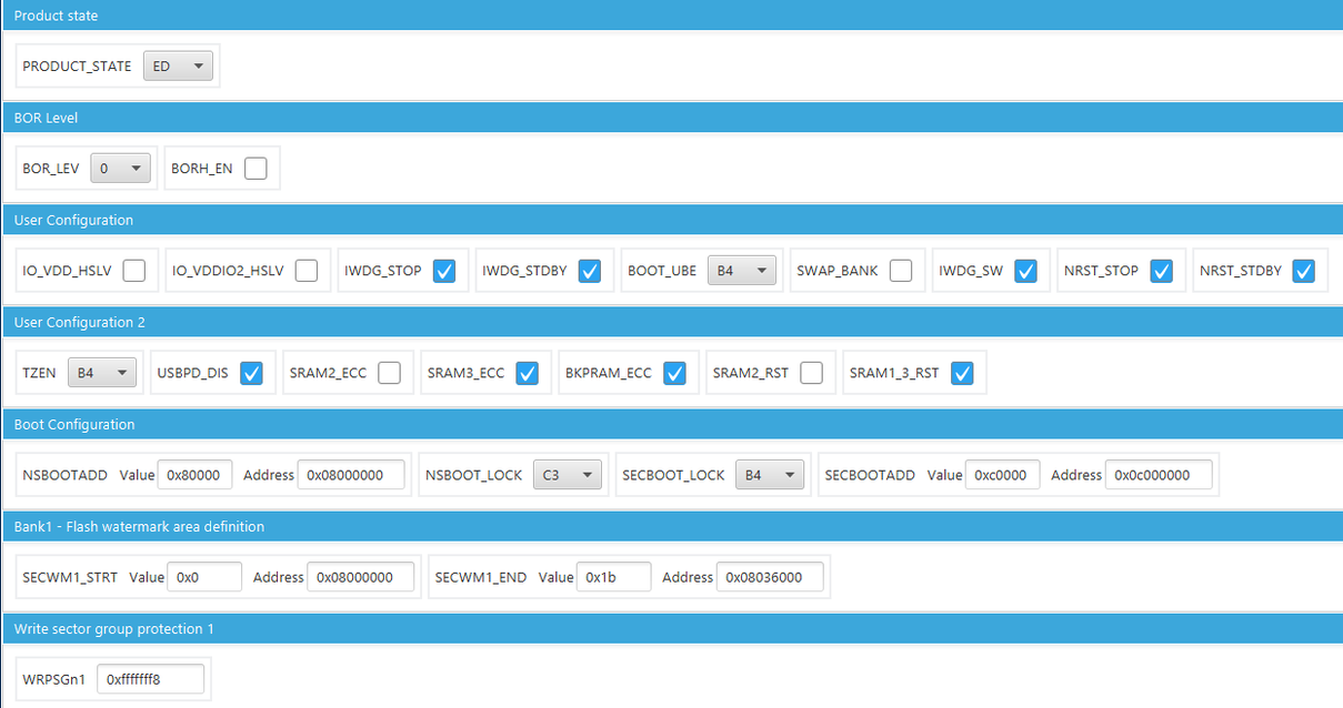

Also, below are my option byte settings for your reference.

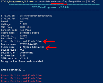

1. I find CLI using hot plug mode with software reset can't read the flash size  
> STM32_Programmer_CLI.exe -c port=SWD mode=hotplug freq=4000 -e [76 91]

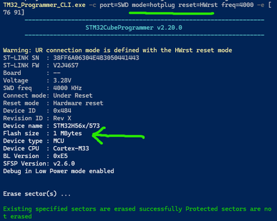

2. I change the reset mode to hardware reset, then the CLI can perform the erase command
> STM32_Programmer_CLI.exe -c port=SWD mode=hotplug reset=HWrst freq=4000 -e [76 91]
But the result is the same, sectors 20 ~ 27 erased by STM32_Programmer_CLI.

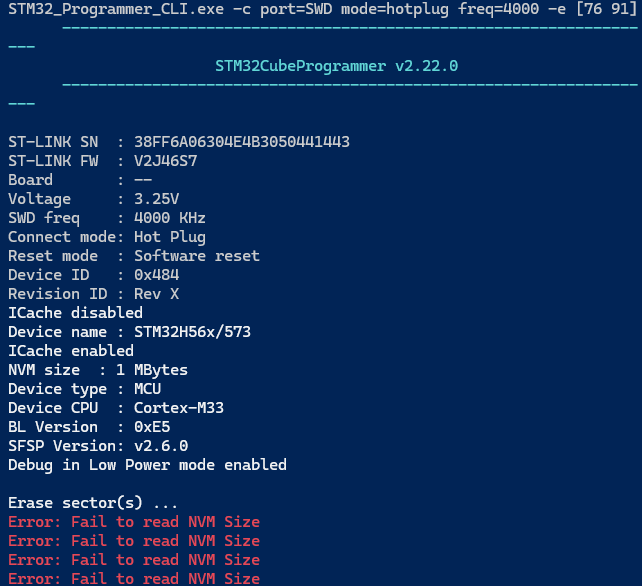

Hi Aziz,
I switched to v2.22.0 CLI hotplug mode but couldn't execute erase.
Regards,
Snaku
