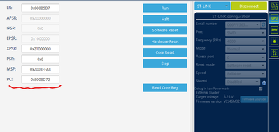

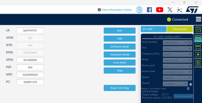

2025-10-21 3:26 AM - edited 2025-10-21 3:28 AM
Hi @haniehsaee,
You can try using the CPU tab to check the value of PC register and now whether your MCU is properly executing the app. The address should be in flash somewhere at 0x08000000 :

2025-10-21 3:42 AM
Yes, the address is around 0x08000000.
