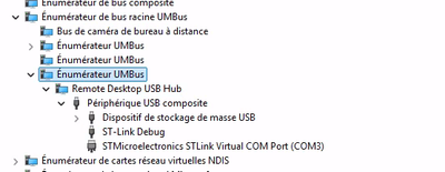

I installed the driver, the device is detected via USB Redirection

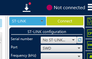

but STM32CubeProgrammer doesnt detect the interface:

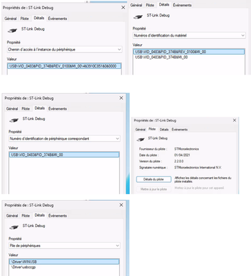

In any case (mstsc or other client) would like to see the Details view of ST-LINK in device manager: Device instance path, Device stack... ?
( Unfortunately there is no quick way to see if the forwarded ST-LINK device has the required device interface property.)

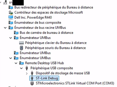

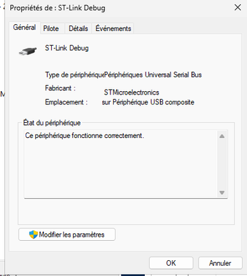

Some details for ST-Link Debug device (sorry it's in french) as seen on the RDSH host
2026-01-28 6:51 AM
KeyName Data
{3464F7A4-2444-40B1-980A-E0903CB6D912} 10 3
{80497100-8C73-48B9-AAD9-CE387E19C56E} 6 0
{83DA6326-97A6-4088-9453-A1923F573B29} 10 ...2dcee32&0&tsusb-session7-3735928569&1&43b4c4ca-779c-4480-a60c-4c98dc6c1a85
{83DA6326-97A6-4088-9453-A1923F573B29} 15 True
{83DA6326-97A6-4088-9453-A1923F573B29} 3 oem16.inf:c14ce8840c48fa1f:USB_Install:2.2.0.0:USB\VID_0483&PID_374B&MI_00
{A8B865DD-2E3D-4094-AD97-E593A70C75D6} 16 {winusb.inf}
{A8B865DD-2E3D-4094-AD97-E593A70C75D6} 26 False
DEVPKEY_Device_BaseContainerId {BCACF260-E606-5703-AA12-F57AB854E792}
DEVPKEY_Device_BusNumber 0
DEVPKEY_Device_BusReportedDeviceDesc ST-Link Debug
DEVPKEY_Device_BusTypeGuid {9D7DEBBC-C85D-11D1-9EB4-006008C3A19A}
DEVPKEY_Device_Capabilities 130
DEVPKEY_Device_Class USBDevice
DEVPKEY_Device_ClassGuid {88BAE032-5A81-49F0-BC3D-A4FF138216D6}
DEVPKEY_Device_CompatibleIds ...ass_ff, USB\COMPAT_VID_0483&Class_ff, USB\Class_ff&SubClass_ff&Prot_ff...}
DEVPKEY_Device_ConfigFlags 0
DEVPKEY_Device_ConfigurationId oem16.inf:USB\VID_0483&PID_374B&MI_00,USB_Install
DEVPKEY_Device_ContainerId {BCACF260-E606-5703-AA12-F57AB854E792}
DEVPKEY_Device_DeviceDesc STMicroelectronics STLink dongle
DEVPKEY_Device_DevNodeStatus 25174026
DEVPKEY_Device_Driver {88bae032-5a81-49f0-bc3d-a4ff138216d6}\0000
DEVPKEY_Device_DriverDate 01/04/2021 02:00:00
DEVPKEY_Device_DriverDesc STMicroelectronics STLink dongle
DEVPKEY_Device_DriverInfPath oem16.inf
DEVPKEY_Device_DriverInfSection USB_Install
DEVPKEY_Device_DriverProvider STMicroelectronics
DEVPKEY_Device_DriverRank 16711681
DEVPKEY_Device_DriverVersion 2.2.0.0
DEVPKEY_Device_EnumeratorName USB
DEVPKEY_Device_FirstInstallDate 28/01/2026 15:29:44
DEVPKEY_Device_FriendlyName ST-Link Debug
DEVPKEY_Device_HardwareIds {USB\VID_0483&PID_374B&REV_0100&MI_00, USB\VID_0483&PID_374B&MI_00}
DEVPKEY_Device_HasProblem False
DEVPKEY_Device_InLocalMachineContainer False
DEVPKEY_Device_InstallDate 28/01/2026 15:29:44
DEVPKEY_Device_InstallState 0
DEVPKEY_Device_InstanceId USB\VID_0483&PID_374B&REV_0100&MI_00\4&3910C851&0&0000
DEVPKEY_Device_IsPresent True
DEVPKEY_Device_IsRebootRequired False
DEVPKEY_Device_LastArrivalDate 28/01/2026 15:29:44
DEVPKEY_Device_LegacyBusType 15
DEVPKEY_Device_Manufacturer STMicroelectronics
DEVPKEY_Device_MatchingDeviceId USB\VID_0483&PID_374B&MI_00
DEVPKEY_Device_Parent ...2dcee32&0&tsusb-session7-3735928569&1&43b4c4ca-779c-4480-a60c-4c98dc6c1a85
DEVPKEY_Device_PDOName \Device\000000f6
DEVPKEY_Device_PowerData {56, 0, 0, 0...}
DEVPKEY_Device_ProblemCode 0
DEVPKEY_Device_RemovalPolicy 3
DEVPKEY_Device_RemovalPolicyDefault 3
DEVPKEY_Device_ReportedDeviceIdsHash 1655816723
DEVPKEY_Device_SafeRemovalRequired False
DEVPKEY_Device_Service WinUSB
DEVPKEY_Device_SessionId 7
DEVPKEY_Device_Siblings ...4&3910c851&0&0001, USB\VID_0483&PID_374B&REV_0100&MI_02\4&3910c851&0&0002}
DEVPKEY_Device_Stack {\Driver\WINUSB, \Driver\usbccgp}
DEVPKEY_NAME ST-Link Debug
