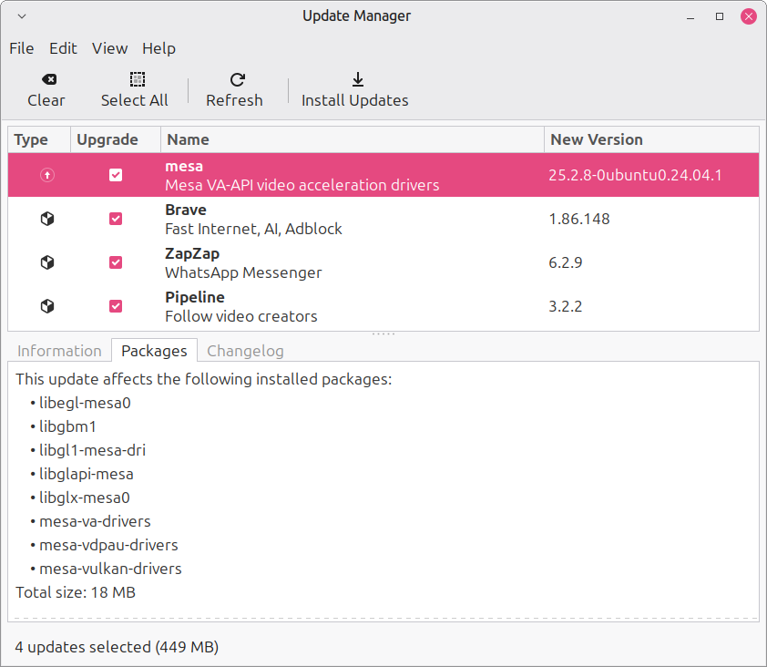

The affected packages are the ones listed in the screenshots:
• libegl-mesa0
• libgbm1
• libgl1-mesa-dri
• libglx-mesa0
• mesa-libgallium
• mesa-va-drivers
• mesa-vdpau-drivers
• mesa-vulkan-drivers
In my specific case, the issue was triggered when upgrading from version 25.0.7 to 25.2.8.
