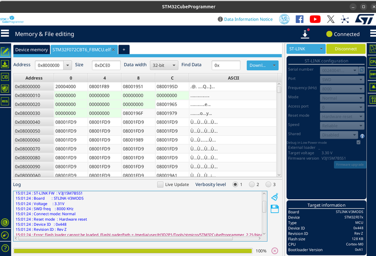

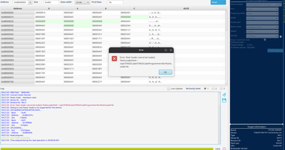

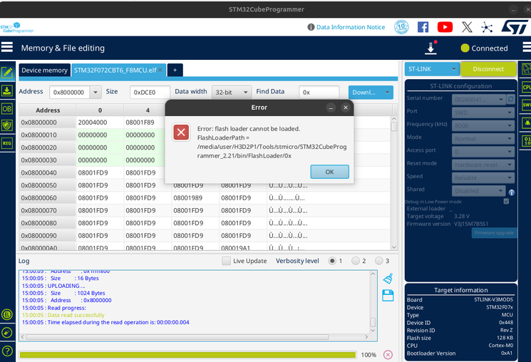

I have exactly the same issue with STV3MOD. Ubuntu 25.10.
Actually, I wrote code I against the STV3MOD libraries and it works fine, for example for using the CAN interface.
But when using SWD I get this same error. Tried v 2.16, 2.18, 2.20 and 2.21. I Also need to start the programmer with sudo otherwise it does not detect the STV3MOD.
Using the programmer usingh USB with the same target device (STM32F072) with STprogrammer works fine.
Copying the file $ cp 0x448.stldr 0x.stldr did not fix it
I went back to an older copy I had installed 2.14 and everything works fine with STV3MOD. So 2.14 seems the better version to use when using STLINK.
2026-01-11 11:00 PM
Hello @debugging ,
Use this instead as this workaround requires the file to be named " 0x " without any file extension.
cp 0x448.stldr 0xWe will keep you updated as soon as this issue is resolved.
