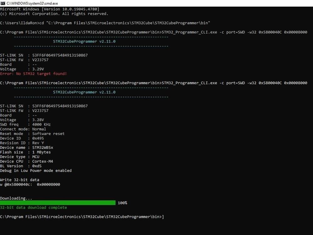

Hello, I have a problem with the return of the STM32WB to the factory settings
When I use the next command
STM32_Programmer_CLI.exe -c port=SWD -w32 0x5800040C 0x00008000
that looks like that
But finally, when I read FUSE I saw that Stake was not removed and FUSE (was not updated, because I uploaded an old version for testing).
I used the custom PCB board and didn't use BOOT0 during my command if it was necessary.
So does any alternative exist to return factory settings?
