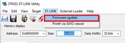

2024-09-15 10:39 AM
Hello @jlourencao and welcome to the community,
Disconnect and reconnect the cable and try again.
Try to use STLink firmware upgrade downloadable from here: https://www.st.com/en/development-tools/stsw-link007.html
If It doesn't work, use STLINK utility (a depricated tool) to update the STlink firmware,
downloadable from here.
Hope it helps.
