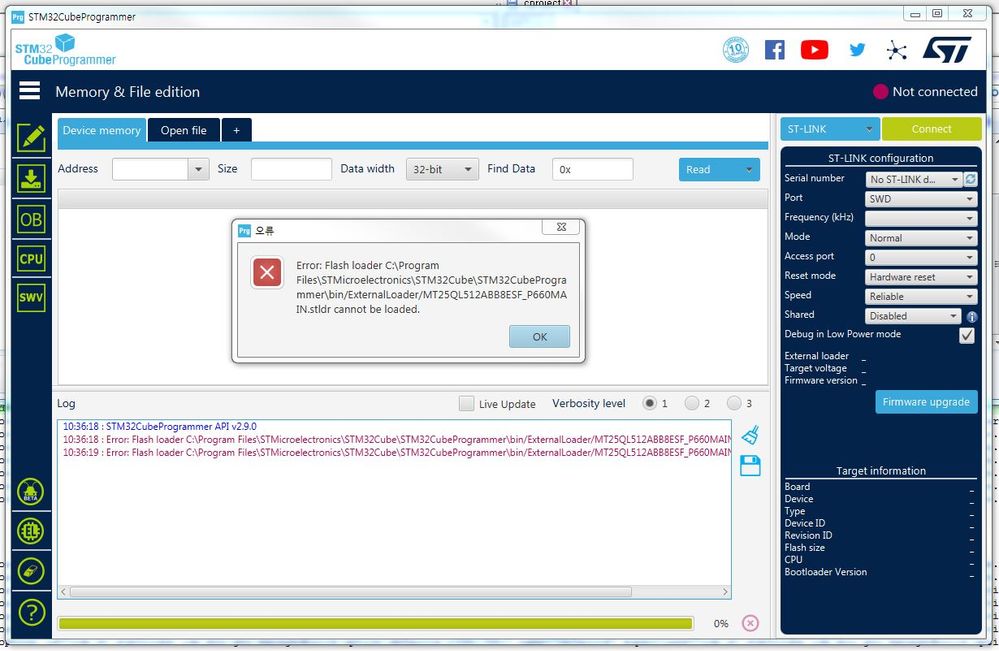

I have porting to h750 based on the provided code, but the following error occurs. error message appears, and sometimes Cube Prog does not run. What could be the cause? Where should I review?

If the file didn't build properly, copy/rename correctly or is simply not there?
You *really* shouldn't use the "Program Files" directory to copy/store user generated code, I'd suggest putting the tools in a C:\STM32 directory where the ownership and virtualization issues are less opaque.

I think there might be a problem with the build of the file.
Where should the code be reviewed?
Change the tool installation location and try again.
