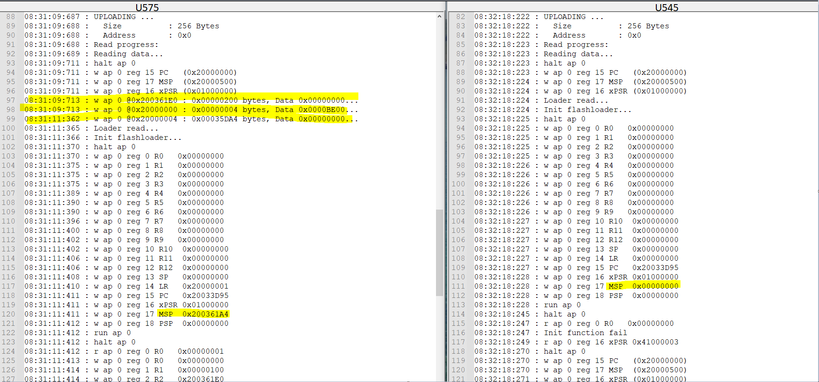

From the logs (the figure below shows an extract of the reading procedure for both micros) I've noticed that in the case of the U545 it seems that the ExtLoader binary is not loaded into RAM, unlike what happens on the U575 (lines 97-99 of the U575 log, absent in U545). Following this (and probably related to the previous problem..) the Main Stack Pointer of U575 seems to point to a coherent memory location, while on U545 it points to zero.

Correct it doesn't look to load it into RAM

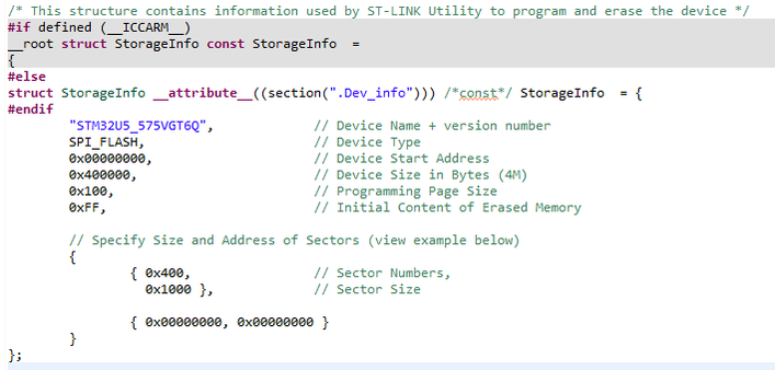

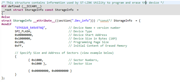

Correct, my external memories are both SPI flash and the used address for them is zero, it works on U575. I've tried to change it to 0x70000000 or 0x80000000 but the error result on U545 is the same. The memory used with U575 has 4MB size, the one used with U545 has 16MB size. These are the two StorageInfo screenshot from my code:
