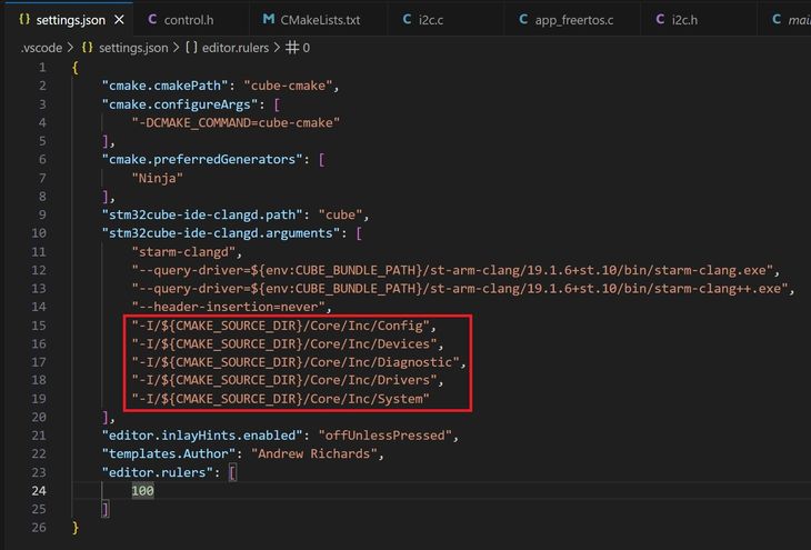

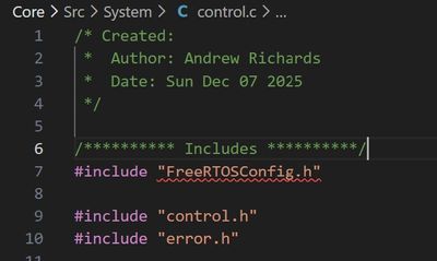

Initially there was no issue, and everything worked fine after disabling intellisense. However, I have now become plagued by the stubborn red squiggles which refuse to disappear whatever I do. I would prefer to continue using VSC, but will have to ditch it and move to another IDE if this problem does not go away, as I cannot work like this. Further down the file there are many other red squiggles. The project compiles fine, no issues there. An example of the problem:

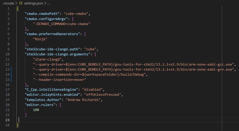

No matter what I do, the first #include has red squiggles under it. If I change the order of the #includes, then it is always the first one which has the squiggles. settings.json file:

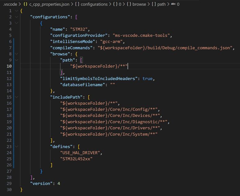

c_cpp_properties.json file:

I finally found a solution to eradicate this problem. It appears that clangd can automatically look in some project folders for headers, but not all, especially ones which have not been auto-generated. Adding the following lines to settings.json stopped the red squiggles.
Thank you for your help, it has enabled me to learn much more than I would have done otherwise. Unfortunately, the "Go to Definition" (F12) has stopped working (not as a result of the above additions), so I now have to find out what is causing that.

CMake Tools has the ability to copy the "compile_commands.json" file it generates to another directory. To do this, use "cmake.copyCompileCommands" setting in "settings.json", and set the value to e.g. "${workspaceFolder}". This copies the file to the workspace root, and you can then use "${workspaceFolder}" in ST Arm clangd's "--compile-commands-dir" as well.

Thanks. I have just altered a line in settings.json to the following:
The red squiggles have gone away...for now. Still worried they may come back though, so I'll take a look at the other response too.

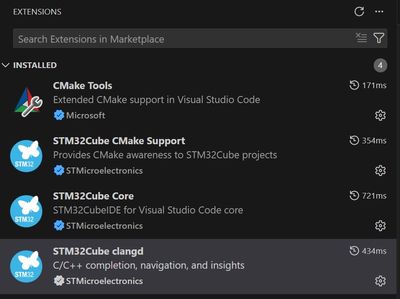

After creating a new profile and including just the basic extensions, the list looks like this:
The last one, STM32Cube clangd appears to cause the red squiggle problem. Disabling it makes the red squiggles go away. Building will still work fine with no errors without this extension enabled. Hovering over the red squiggle shows the following:
Presumably clang cannot find FreeRTOSConfig.h, but as I said previously, the red squiggle is applied to whichever header file is placed first in the file. The directories where header files are saved are referenced in CMakeLists.txt under target_include_directories(). CMake itself appears to have no issue finding them. If I comment out a header file directory in CMakeList, then CMake complains as expected.

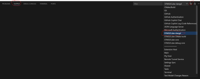

In VSCode, close the file which is causing the problem. Then open "Output" pane at the bottom and change the drop-down to "STM32 Cube clangd", and clear the window's content:
After doing this open the problematic .c file. You should see output in the pane. Does it provide any error messages or clues as to what might be going wrong?
