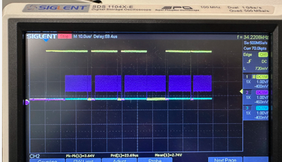

What is the frequency of xspi?
Can you specify which curves you are observing on the oscilloscope?

Hi Kaouthar,
Thanks for your information!
The XSPI in this screenshot is running at 133MHz (max for the memory) but I had previously already tried running at lower speeds with little success.

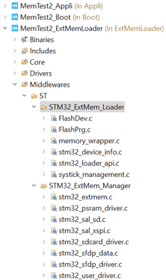

I have taken a look at AN5050 and I'm struggling to differentiate the difference between the example code and the purpose of the External Memory Manager & External Loader middlewares.
My understanding was that the external loader runtime context took care of the programming, and that NOR-SFDP handled the runtime XIP or load and run.
I must admit I am not a firmware guy (actually a mechanical engineer) and my understanding of drivers and HALs are 'vibe' based as they are calling it now.
I guess I asking if I should expect the external loader & manager middlewares to handle the memory programming protocol. Right now the Macronix SPI communication is a complete black box to me, however it seems the datasheet is quite detailed...
With my issue of seeing part 0x00... and 0xFF..., it seems to me I am missing some fundamental idea of erasing/programming it that the default external loader is not taking care of. In your experience, do the external loaders typically 'just work'?
