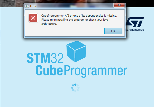

I updated the STM32CubeProgrammer from version V2.10 to version 2.17, but it doesn't work on my computer (Windows 7 ). I installed new version on Java, reinstalled program, it didn't help.

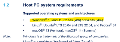

Windows 7 isn't supported.
STM32CubeProgrammer ships with its own Java, so you shouldn't need to do anything there.
Could be antivirus software interfering, but it could also just be fundamentally incompatible with Win7.
