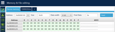

The STM32CubeProgrammer GUI can read this memory in the Memory & File editing view Device memory tab by entering the Address and amount of data to be read. You can enter and read any address and range within EEPROM.

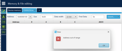

However the Memory & File editing view cannot be used to download data from a binary file into an arbitrary location in EEPROM such as 0x08080100. If you open a binary file in a new tab and try to set the address to 0x08080100, it will display an Address out of range error dialog.
This is not critical since you can still download to an arbitrary address in EEPROM using the Erasing & Programming tool within the GUI (or use the CLI tool), but it seems to clearly be a bug and there's no need for everyone to have to figure out the problem and the workaround...so I'm documenting it here.

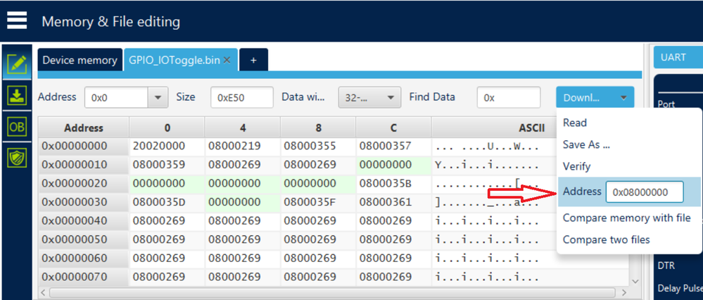

Hello @DAlbe.3,
After investigation, it appears that the address field in the file tab is associated with the Read operation inside the currently opened file (e.g. 0x10, 0x40…), while the start address for programming is located under the Download button:
I understand this can be misleading, so the ticket has been converted to a change request to update the UI by swapping the positions of the Download and Read buttons, making it clearer that the address field belongs to the read operation.

Hello @DAlbe.3,
