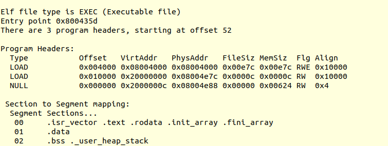

Hi, I have an ELF file modified to write to the main memory address 0x08004000 instead of 0x08000000. Please find the screenshot below and the ELF file in the attachment.
But instead of writing to 0x08004000 it constantly writes to 0x08000000. Why is this happening?

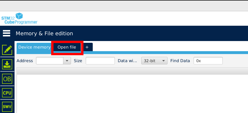

Hi @bob S, there is a tab named Open file in the IDE by which I had opened it.
2023-05-10 3:31 AM
Hi @yo3hcv, thanks for pointing it out. I will try this fix.
2023-05-10 5:42 AM - edited 2023-11-20 6:17 AM
This fix solved my issue. Now I can see the updated address in the program header
