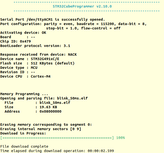

Hi, I have an ELF file modified to write to the main memory address 0x08004000 instead of 0x08000000. Please find the screenshot below and the ELF file in the attachment.
But instead of writing to 0x08004000 it constantly writes to 0x08000000. Why is this happening?
No, you haven't. Your screenshot shows the old address, as well as
$ arm-none-eabi-readelf -l blink_50ms.elf
Elf file type is EXEC (Executable file)
Entry point 0x800435d
There are 3 program headers, starting at offset 52
Program Headers:
Type Offset VirtAddr PhysAddr FileSiz MemSiz Flg Align
LOAD 0x000000 0x08000000 0x08000000 0x04e7c 0x04e7c RWE 0x10000
LOAD 0x010000 0x20000000 0x08004e7c 0x0000c 0x0002c RW 0x10000
LOAD 0x00002c 0x2000002c 0x08004e88 0x00000 0x00604 RW 0x10000
